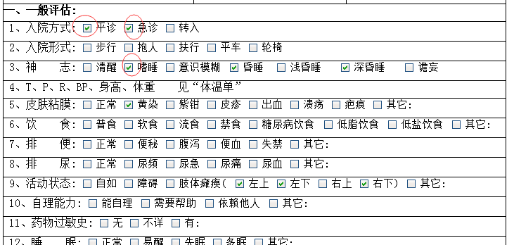

Re: GetItemStyle
Thank you very much, waiting for your presentation... I'll show you a screenshot of the color of the control.
- QQ图片20170727091225.png (28.81 KiB) Viewed 58027 times
