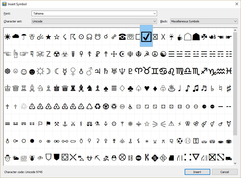

For example, this is a screenshot of our "Insert Symbol" dialog to insert symbol of Tahoma font:
jimmaguire

Post by jimmaguire »
Thanks, that screen shot makes it clear.
