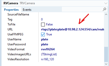

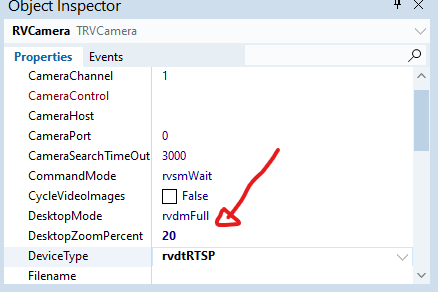

I am trying to access via RTSP a camera using component. Already insert libraries
which are in the topics:
forums/viewtopic.php?f=17&t=9285
forums/viewtopic.php?f=17&t=6880
But I don't have the video.
is my public camera address: rtsp://plate:[email protected]:554/cam/realmonitor?channel=1&subtype=0
Anotação 2019-11-25 133801.png (14.84 KiB) Viewed 22969 times
Anotação 2019-11-25 133656.png (16.18 KiB) Viewed 22969 times

1) If you use version 7.0, please upgrade to version 7.1. And re-test.
2) Can it be played with this demo: www.trichview.com/support/files/CamTest.zip ?

Thanks! I Update it's work now!
