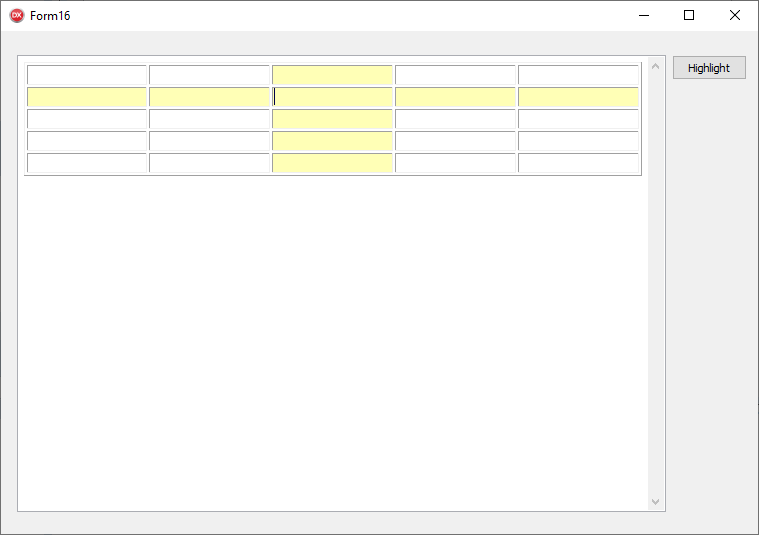

Marking the whole table row and the whole table column of a focused table cell
my code for marking the whole table row and the whole table column of a focused table cell works as long as I put the code into a panel (.sbTabZeilefaerbenClick (Sender: TObject)).
But if I set it in .memoRVDblClick (Sender: TCustomRichView; ClickedWord: TRVUnicodeString; Style: Integer) I get an 'Abstract Error'.
What can I do - when I click on a cell - the whole table row and the whole table column of the focused cell are highlighted in yellow?

Does really nobody know what a solution could look like, if you click in a rveTabelle (rve: RichViewEdit) to get the 'cross' - in the intersection of which the focused cell is located?
My solution requires 2 steps:
1. Click on the cell
2. Click the switch '.sbTabZeilefaerbenClick'.

- Posts: 17899
Re: Marking the whole table row and the whole table column of a focused table cell
That demo shows how to solve your problem: running from inside mouse/drag event a code that cannot be executed inside this event.
But ok, I'll make a project for you tomorrow.
- Posts: 17899
Attached.
I used OnRVMouseDown (with ssDouble in Shift check) instead of OnRVDblClick, because OnRVDblClick is not called when users click on an empty space.
- HighlightCell.zip
- (50.03 KiB) Downloaded 2107 times

- Posts: 17899
In my demo, this highlighting works both when you click on the button and when you double click in the cell.

- Posts: 17899
My example does not require to press Shift key.
The check
in OnRVMouseDown allows detecting a double click. Shift is the parameter name, not the Shift button.
To detect only left mouse button double click, the condition must be changed to:
But I found a bug in the code. rveTable.GetNormalizedSelectionBounds must be moved before try...except, otherwise an exception may occur when the caret is to the left or right side of the table (because rveTzeile1, rveTspalte1 will not be assigned in this case).
I attached a fixed version.
The check
if ssDouble in Shift then
if (Button = mbLeft) and (ssDouble in Shift) then
- HighlightCell2.zip
- (50.04 KiB) Downloaded 2261 times
