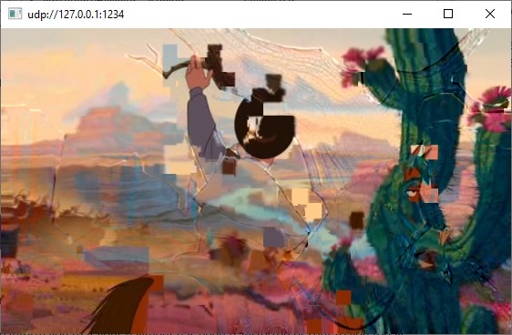

I can see video artifacts in ffplay when displaying local udp stream.
Periodically, video becomes distorted.

Well, may be periodically smth is distorted.
But in my case picture becomes corrupted in 30 seconds from start and then never restores.
Watch please this: https://yadi.sk/i/vNDmBlwFdEB8Mg and this: https://yadi.sk/d/VmxWkiIt0JuwXA
