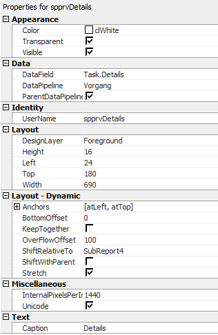

In my Report, I have a "ppRichView" with these settings. (attached SettingsPPRichView).

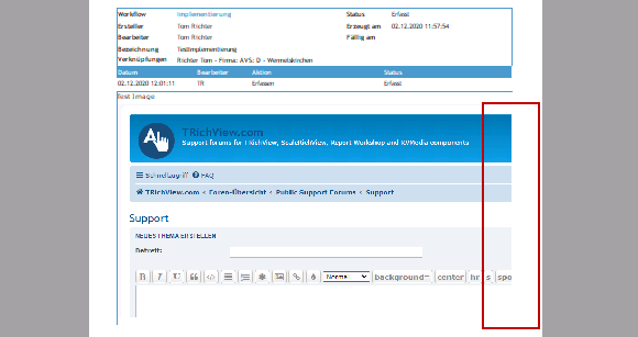

If I paste a picture that is larger than the report's width into the connected richedit and opens the print preview, this happens. (attached ExamplePrintPreview)
It seems like the picture is cut. Is there anything I can do to scale the inserted picture automatically?

Sorry, this feature is not implemented, the component cannot define the width of images relative to the document width.
Modifying images at the moment of insertion is not simple as well, because additional indents and margins affect the total width, and they are known only when the document is formatted.
