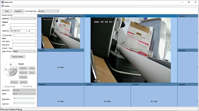

Re: Latency and ffmpeg
Thank you for your reply,
I can get video with your compiled exe as you can see in this screenshoot
My problem is latency 2s, as i mentioned i reduced latency to 0 but no result.
How can i use udp in Media Test ?
I downloaded recent DLL (04/09/2021) for FFmpeg but it's not work (i am in 32 bits).
Thank's
Chouk
Thank's
Chouk
- Image1.png (73.93 KiB) Viewed 26810 times

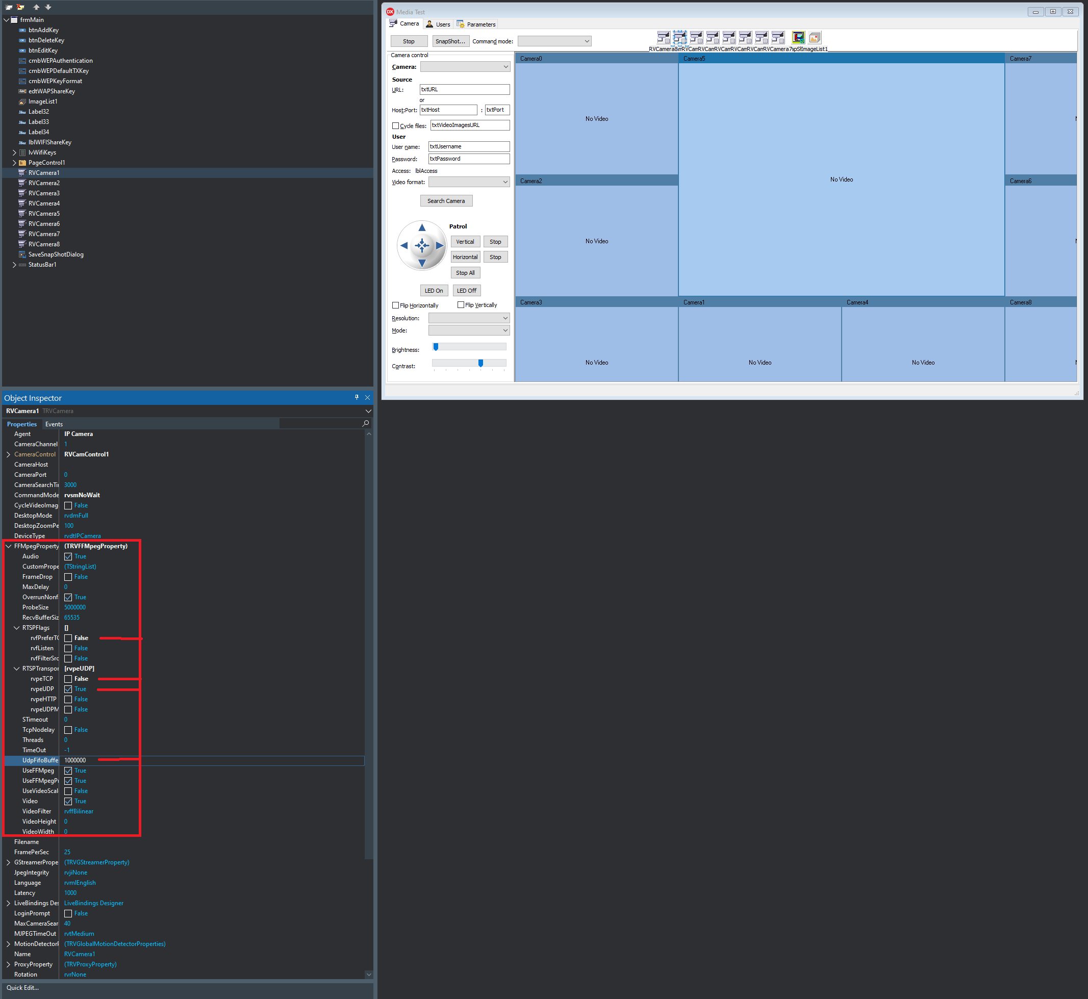

- Posts: 17898
The protocol may still be RTSP (I assume you use 'rtsp:' URL?)
But internally, RTSP protocol may be based on UDP or HTTP.
To use RTSP on UDP, assign RVCamera.FFmpegProperty.RTSPTransport := [rvpeUDP]
