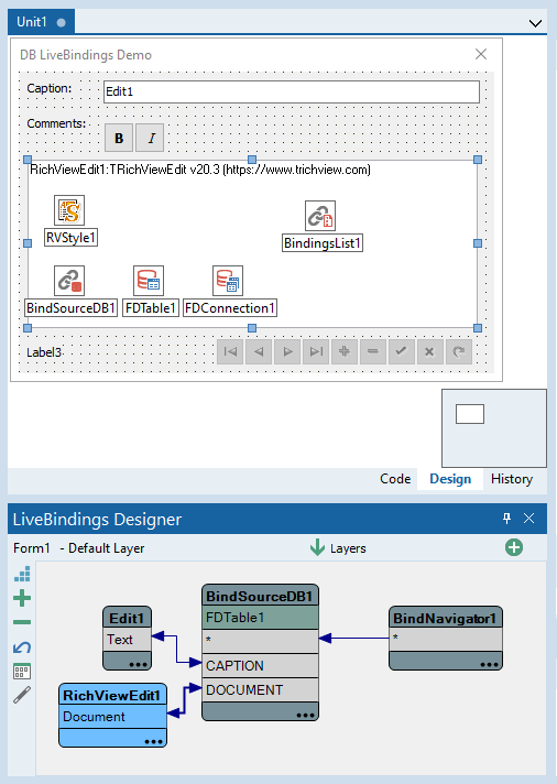

A new property Document is added to TRichView, TRichViewEdit, and TSRichViewEdit components.
The main use of this property is linking a TRichView/ScaleRichView control to a database field of TBlobField type.
On the screenshot below, you can see how TRichViewEdit is linked to a blob field, and TEdit is linked to a text field:
This is a design-time screenshot of the new demo placed in TRichView\Demos\DelphiUnicode\DB Demos.FireDAC_IB\4 LiveBindings\
(or C++Builder version in TRichView\Demos\CBuilderUnicode\DB Demos.FireDAC_IB\4 LiveBindings\).
This is the analog of TRichView\Demos\DelphiUnicode\DB Demos.FireDAC_IB\1 DBRichViewEdit\, but it uses LiveBindings instead of a special data-aware component. This demo uses FireDAC and InterBase server.

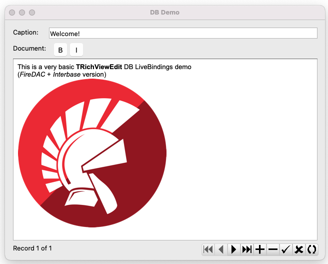

A FireMonkey version of this demo is available as well, in TRichView\Demos\Delphi.FMX\DBDemos\DBLiveBindings.FireDAC_IB\. This demo uses FireDAC and InterBase server for Windows, and IBLite for macOS. The macOS screenshot is below:
This is the first DB-related TRichView FireMonkey demo, because FireMonkey requires LiveBindings for linking controls to database fields.
Even if you do not use TDBRichView and TDBRichViewEdit components, for linking TRichView and ScaleRichView to a database field, include DBRV (for VCL) or fmxDBRV (for FireMonkey) in your projects. This unit implements assignments between TRichView Document and TBlobField.

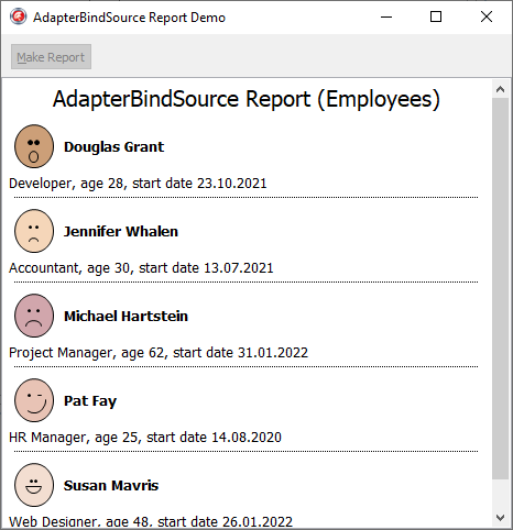

ReportWorkshop\Demos\Delphi\LiveBindings\AdapterBindSource\: data from programmer-defined classes
This demo implements a class TEmployee that contains a name, a position, an age, a starting working date, and a "photo" of a person.
It creates a list of these objects and uses TAdapterBindSource to provide data from this list using LiveBindings. Then it uses TRVReportBindSourceDataProvider to get data from this TAdapterBindSource for a report.
