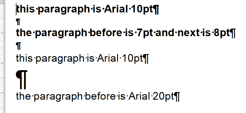

docx files saved with Word are missing <w:r> .. </w:r> element for empty paragraphs there is only a <w:pPr> element setting font and style and so on inside <w:rPr>, but currently this element is not taken into account durring loading. The result is that empty paragraphs get the default font and style assigned.
Original in Word - the empty paragraphs have a different Font / Size Syle:

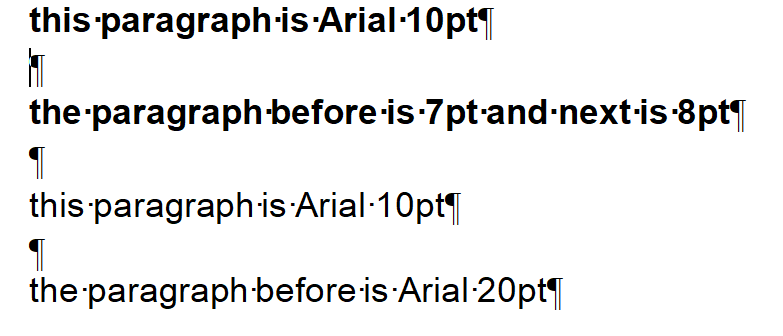

After TRichView Save all empty lines share the default font and style.
(TRichView currently saves a <w:r> element also for empty paragraphs is this really required for some word process application?)
