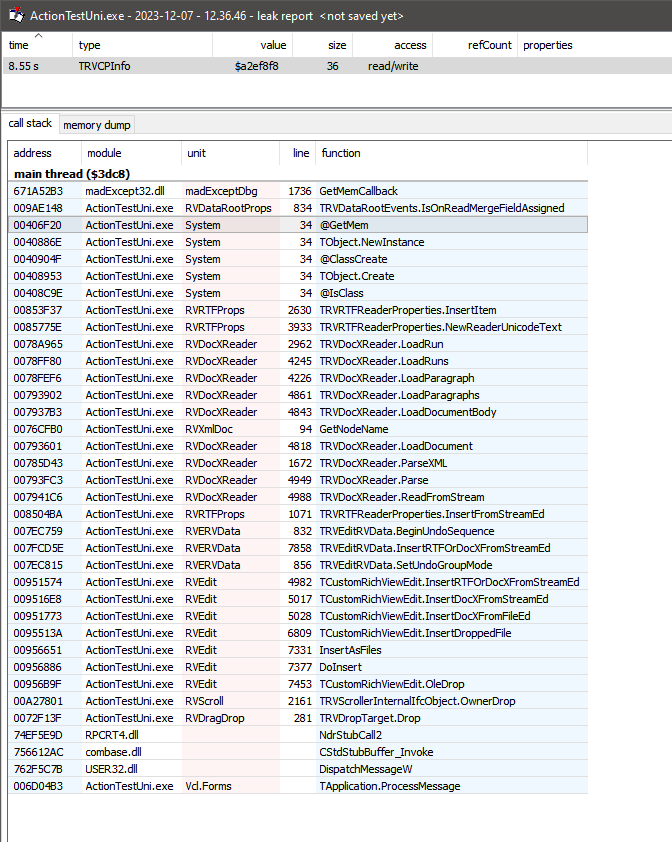

I'm still using rve version 21.7.3. When using an rvActionOpen to open a Word docx file, it opens OK, but I'm getting a leak reported by madexcept in TRVCPInfo (see attached screenshot) when I close the app. This seems to only happen with Word files, but I haven't tried it with every possible file type. Seems to be OK using a text or rvf file. Just docx files are causing the leak whether I open them or drag and drop them in.
I used the ActionTestUni demo to make sure it wasn't something I introduced in the code.

I confirm the problem.
Quick fix (VCL/LCL version):
Open RVRTFProps.pas
Change the code starting from the line 2764 from
      if (InsertPoint > 0) and item.SameAsPrev and (item.StyleNo >= 0) and
        (CurrentRVData.GetItemStyle(InsertPoint - 1)= item.StyleNo)
       then
to
        (CurrentRVData.GetItemStyle(InsertPoint - 1) = item.StyleNo) and
        (item.Checkpoint = nil) then

Thanks Sergey, that seems to have fixed it!
