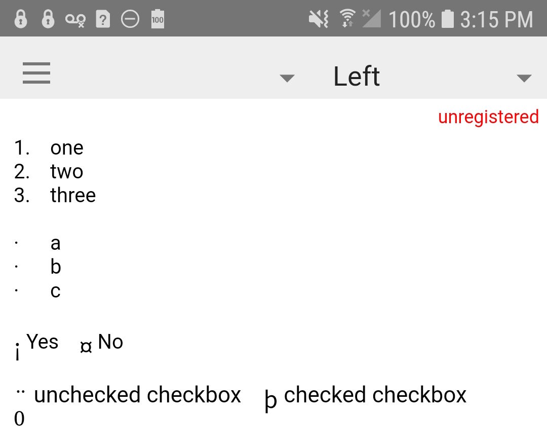

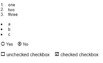

When RTFReadProperties.ConvertSymbolFonts is False, bullets, checkboxes, radio buttons show up fine on Windows. On Android, bullets show up fine, though tiny, but not checkboxes and radio buttons. See "SymbolSet Windows.jpg" and "SymbolSet Android.jpg".

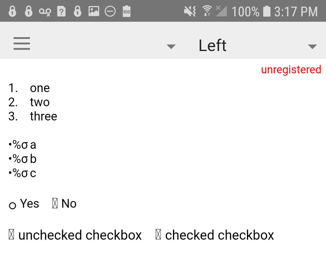

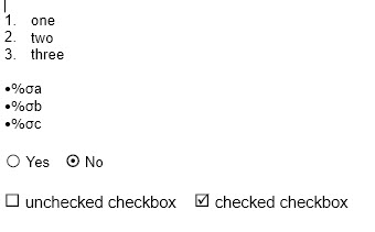

When RTFReadProperties.ConvertSymbolFonts is True, checkboxes, radio buttons show up fine on Windows, but not bullets (double char kind of thing). On Android, bullets come out like they do on Windows (double char thing). Checkboxes and radio buttons are better but not good. Unchecked radio button looks good, but not the checked version. For checkboxes, checked and unchecked are both checked. See "SymbolSet Win Convert.jpg" and "SymbolSet Android Convert.jpg".

I now have the registered version, and I noticed an odd thing in the header for bullets that has a %s in it, which seems a bit off. Example (typed from a screen shot, so there may be typos):
Is this expected? Seems like an unresolved Format tag.

TRichView uses format strings with "%s" placeholders for list text (RVStyles.ListStyles[].Levels[].FormatString).
However, it is expected that "%s" placeholders are used only in FormatStrings for numbered list types (like decimal, Roman, etc.), not for bullets.
So, for bullets, TRichView saves FormatStrings in RTF as they are.
So, the problem is not in RTF saving. The problem is in the code that adds "%s" to FormatString.
As I said before, TRichView RTF-reading code does not expect that number placeholders are inserted for bullets. MS Word and Wordpad never do it, but this problem exists in your RTF sample.
