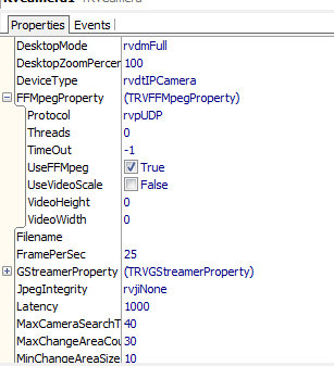

Can't find MaxDelay property in RVCamera.FFMpegProperty

Current version of RVMedia does not allow to pass arbitrary parameters to FFmpeg, only parameters listed in RVCamera.FFMpegProperty.
MaxDelay must be the second property listed in RVCamera.FFMpegProperty in the Object Inspector.
Re: Testing RVCamera - Video blurred
But it isn't there:MaxDelay must be the second property listed in RVCamera.FFMpegProperty in the Object Inspector.

What version of RVMedia do you use? New version has much more properties there.
I used version 6.1
