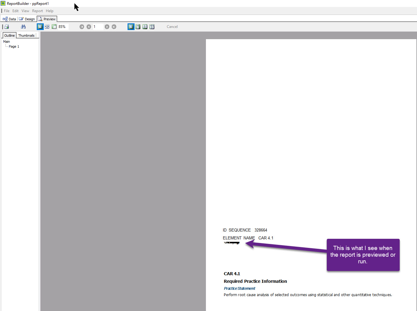

Please see the attached images. Any idea why this is happening?

Garbled rendering of TppDBRichview
- Posts: 29
- Joined: Mon Oct 25, 2010 3:59 pm
- During preview or report generation, the rendering becomes corrupted
- Preview-RuntimeFail.jpg (107.26 KiB) Viewed 23417 times

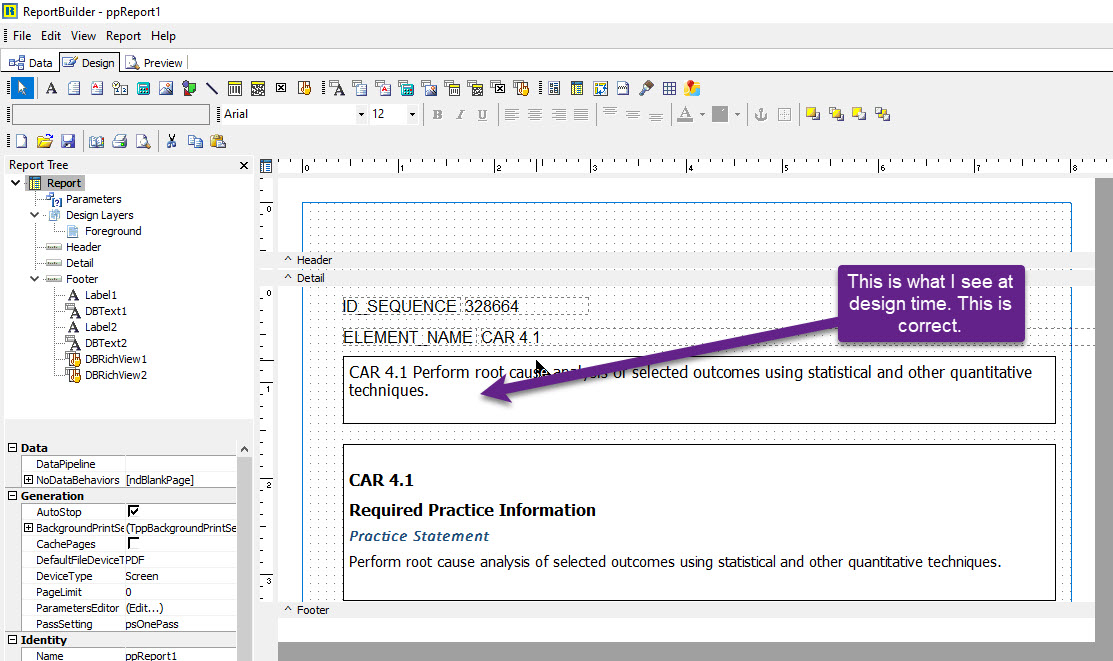

- With dataset active during design the RVF text looks good.
- Desgn-OK.jpg (238.12 KiB) Viewed 23417 times

- Posts: 17899
Re: Garbled rendering of TppDBRichview
This text has font size = 0. When this font is applied to a canvas, results may be different.
I have a guess why this font size may appear.
A very old code of ActionTest demo used rvActionFontEx.Font.Size to implement a font size combobox.
In newer version of RichViewActions, rvActionFontEx.Font.Size must not be used, rvActionFontEx.FontSizeDouble must be used instead. Also, a font size combobox now works automatically, but some users continued to use that code fragment, resulting zero font size in documents.
In the newest version of RichViewActions, both rvActionFontEx.Font.Size and rvActionFontEx.FontSizeDouble can be used, but this fix came too late.
I can suggest a workaround for such documents.
Open RVStyle.pas, find procedure TCustomRVFontInfo.Apply.
At the beginning of this procedure, add
So 10pt will be used instead of zero font size.
if SizeDouble <= 0 then
SizeDouble := 20;
