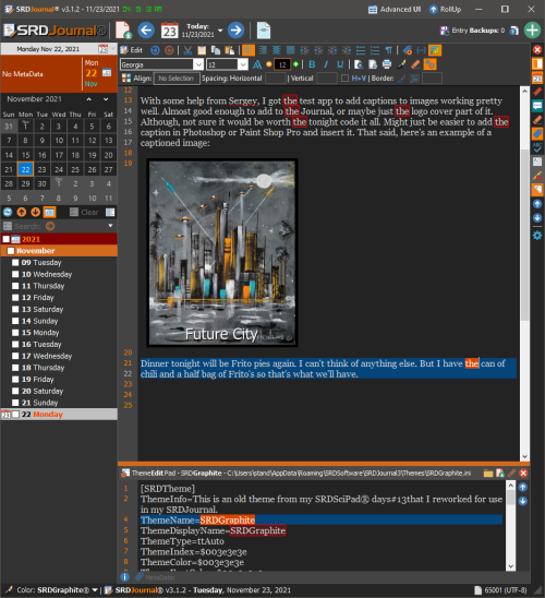

The 2 main rve's have the same "ghost" issue. Note that the actual caret (the one in the center vertically, see screen shots below) is a maroon color which matches the text color which is correct, the other 2 are white "ghosts" (probably clWindow, not clWhite). I am not intentionally drawing white carets anywhere in code that I'm aware of!

Main app window
Main app window
SRDJournal 3.1.2.509-sm.png (158.34 KiB) Viewed 21656 times
