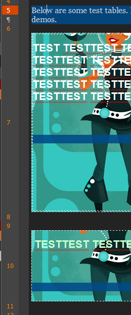

Here's a question not related to line numbers!
I use code in my main rve style to color the para background. Works fine and looks like what I want. However, when I pasted some tables in, the para bgnd is drawing in them and I don't want it in there (see screenshot below). How can I suppress the para bgnd color from drawing into my tables? I've tried everything I can think of and the only way I have gotten rid of the bgnds in the tables is to turn it off for everything!
Line 5 is a regular para and is fine. Lines 7 and 10 are the tables and I don't want the blue para bgnd bar to be drawn in those. If I decide to implement tables at all, it will be to add images like you see in the screenshot. So if the answer is to remove the image from the table that will be an issue.
Thanks Sergey
Thanks Sergey

But if you draw paragraph backgrounds yourself, you can just check if a paragraph contains a table, and do not draw background in this case (?)
Re: Tables Question
Tried that first thing. No go. If I select a line above the table(s), it highlights. Here's the code. Right now I have several attempts commented out but you can get an idea of what I was doing...part of it is the tables have the same itemno's as the rve. I think it's trying to highlight the same item no but I can't seem to get it stopped...Sergey Tkachenko wrote: Sun Jan 02, 2022 8:46 pm But if you draw paragraph backgrounds yourself, you can just check if a paragraph contains a table, and do not draw background in this case (?)

Re: Tables Question
FYI, I tried a plain table with no image, still does it, and in a simple test app and it's still doing it there.

Re: Tables Question
Yes, that all worked. THANKS. The key was this:
I thought it was going to be something like that. And I actually tried things along those lines, but the closest I got was this:
and...
It never occurred to me to set up a separate var and then compare it the way you did. Sigh.
Well, thanks again.
Edit := rve.TopLevelEditor;
if TCustomRVFormattedData(Sender.RVData) <> Edit.RVData then
exit;
if rve = rve.InPlaceEditor then exit;
if rve = rve.TopLevelEditor then exit;
Well, thanks again.
