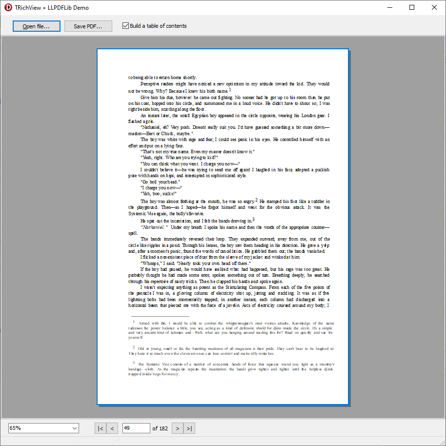

We created an advanced version of this demo that supports a table of contents (TOC) in PDF:
LLPDFWithTOC.zip
(95.69 KiB) Downloaded 11760 times

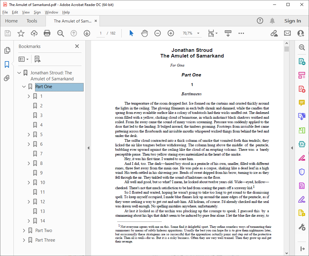

A TOC is built using headings in documents (RTF, RVF, and we also added DocX).
You can see a checkbox "Build a table of contents":
If this checkbox is checked, and a file has headings, they are used to build TOC for PDF:

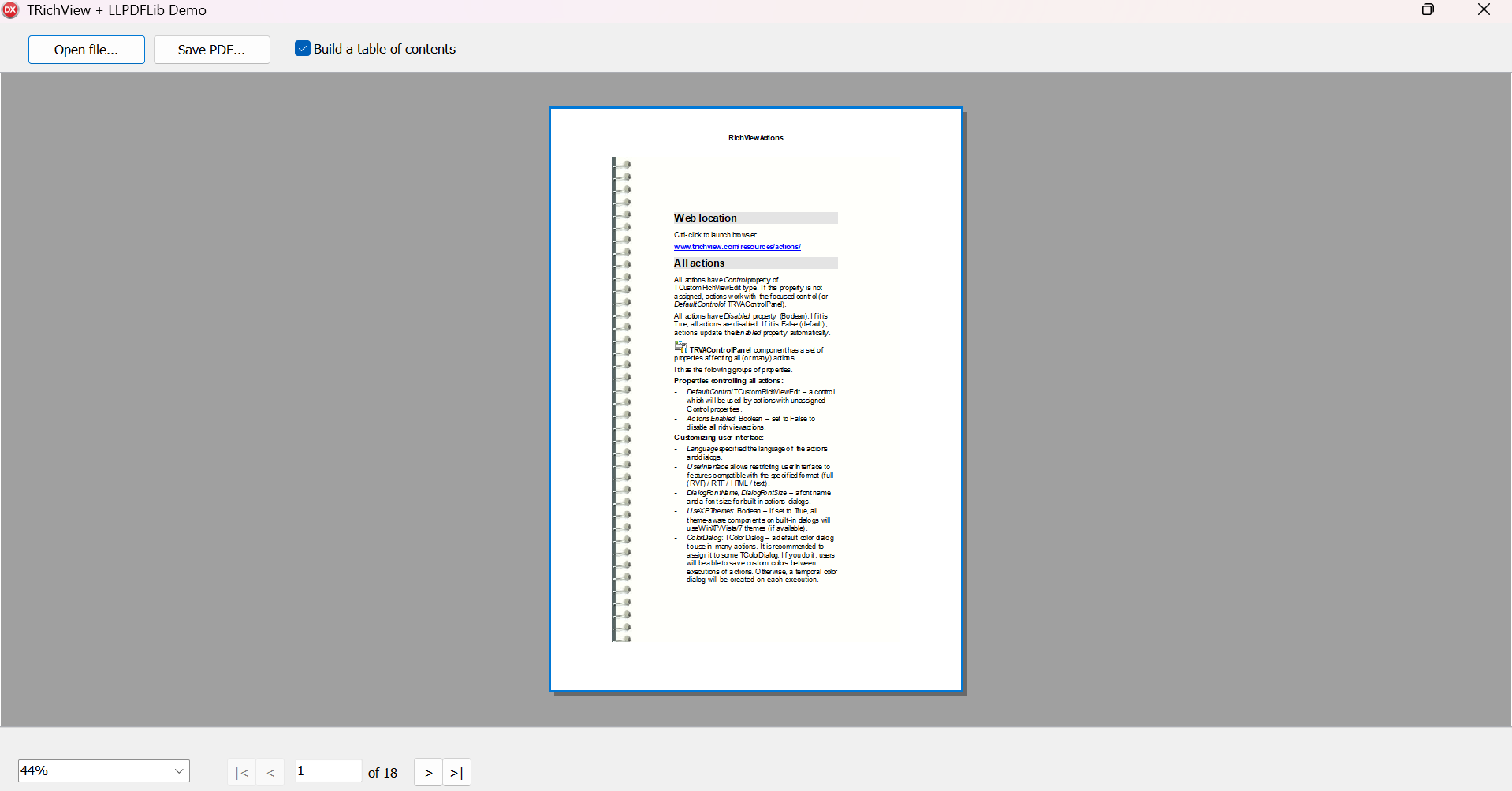

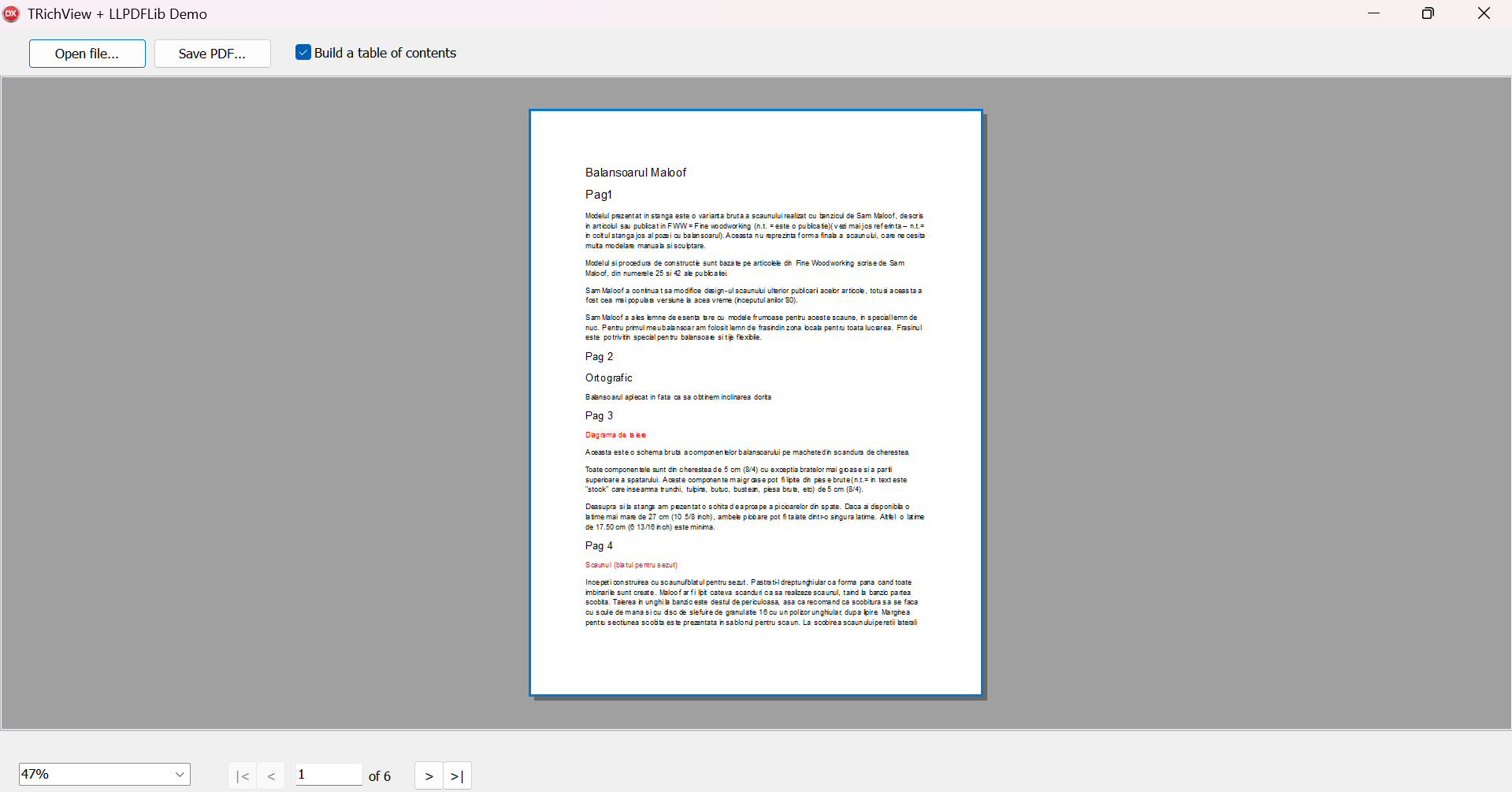

When Load a RVF File look like this:
When load a Docx file look like this:
When I open any RVF file, the border is not set correctly. It can also be seen in the pictures.
Re: [Demo] Making PDF with table of contents using LLPDFLib
Was this PDF created in ScaleRichView?
There are two kinds of margins in RVF documents: page margins + document margins.
Page margins are like in RTF and DocX.
Document margins are like <body> margins in HTML (they do not exist in RTF and DocX files).
In the current version, ScaleRichView saves document margins equal to page margins, and this demo (which uses both these kinds of margins for RVF) will show double margins. If you need, I'll explain how to turn off document margins.
