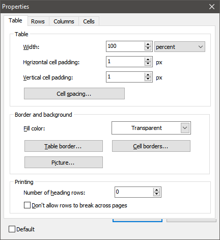

However, I found that with properties dialogs the OK and Cancel buttons aren't positioned correctly:

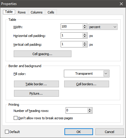

And should look like this:
