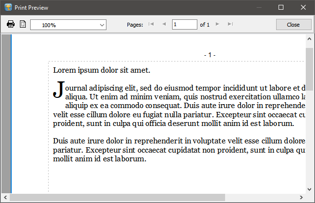

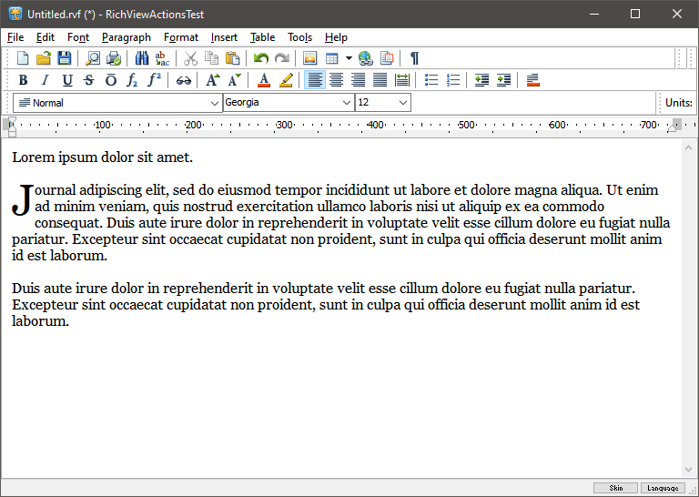

I ran into a problem where the drop cap in the rve looks OK, but in the print preview the vertical position is different. I've been using these lines to fix it
For the regular rve, I do this:
TRVLabelItemInfo(rv.RVData.GetItem(i)).OuterVSpacing := -4;
But for the print preview I do this:
TRVLabelItemInfo(rv.RVData.GetItem(i)).OuterVSpacing := 4;
I don't like using "magic numbers" (in this case plus and minus "4"). I've tried it without that but if I don't set the OuterVSpacing it doesn't position correctly. I've tried various combinations of RemoveInternalLeading and RemoveSpaceBelow and those didn't help.
I'll attach an example rvf file. Put it into the RichViewActionsTest demo and it should look like this:
Then, do a print preview and it looks like this:
I want the drop cap position in the print preview to match the regular rve. My current code is working but I have a feeling there may be a much better way.

Re: Drop Caps (TRVLabel)
Margins are not supposed to be negative.
I have an alternative suggestion: instead of changing margins, you can use RemoveInternalLeading property.
standay
Posts: 303
Post by standay »
Sergey Tkachenko wrote: Thu Mar 16, 2023 8:53 am Margins are not supposed to be negative.
I'm setting both RemoveInternalLeading and RemoveSpaceBelow to true. That seems to take care of the regular rve so I removed setting OuterVSpacing to -4.
However, I still have to set OuterVSpacing to +4 for drop caps in the print preview to align them to match what I see in the rve (to keep them from sitting too high relative to the other para text). +4 seems to be the value needed regardless of font or font size.
Is it correct to have to adjust OuterVSpacing for print preview? I'm thinking it may have to do with dpi but I don't know.
There is a bug: RemoveInternalLeading is processed incorrectly on printing, so the label is drawn higher than it should.
Quick fix: open RVLabelItem.pas. In TRVLabelItemInfo.Print, remove the line
Y := Y + RV_YToDevice(YOffs, sad);
standay
Posts: 303
Post by standay »
Yes, that fixed the print preview! I no longer have to set OuterVSpacing and it all works! Thanks.
