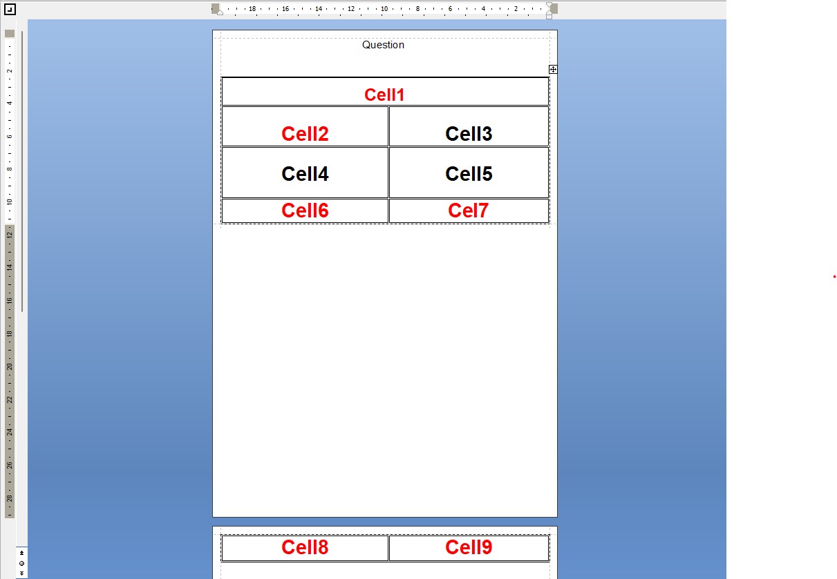

Re: Table.Cells[j,i].AddNL
Hello
I attached a screenshot to explain my self.
As you can see, the last Line of the table(in SRichViewedit document) jumped to a new page. I don't want this to happen!
I could solve this problem by dragging down the sclruler at the left side, however What I really need is to do it by code so the SclRuler is adjusted exactly (without empty area) to include the escaping cells, or other Items which may come after.
I believe that knowing the physical height of the document (containing items without empty areas) is necessary for adjusting the BottomMargin of the page. I tried hard with no success
Please Help!!
Please Help!!
- Posts: 17898
ScaleRichView ruler was designed to work only with cells for the active page (a page that contains the caret), like in Microsoft Word.
If you want to change it to allow resizing cells on all pages, it's a lot of work.
