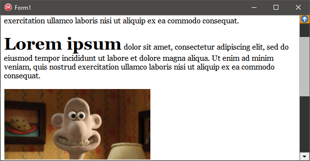

OK, I got curious and downloaded the scalerv trial so I could get hold of a TSRVScrollbar. I set up a simple app using that for a vertical bar. It works OK with the code I posted earlier with one change:
VertScrollBar.PageSize := PageSize ;
to
VertScrollBar.PageSize := PageSize + 1;
Mine works OK with any mix of fonts and font sizes.
It took a while to figure out it needs an SRVSkinManager, and that took a while to figure out as well. It's no problem to change colors of the SB elements, but it looks like you use images for the up and down arrows, as well as thumb "lines" (if you want them).
Since there are draw events for the up, down, and thumb, I tried those and that all works great. I might be able to replace the AT scrollbars with the TSRVScrollbar. I'll do more testing.
BTW, I set the TabStop to false as I've had issues with scrollbars where it was set to true. I have the pagesize set to 0 in design mode (it defaulted to that).
Here's a test with the up arrow button with an orange bgnd and a png image, the sb area a dark gray, the thumb silver, and the down arrow button as it looks normally.
