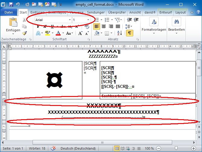

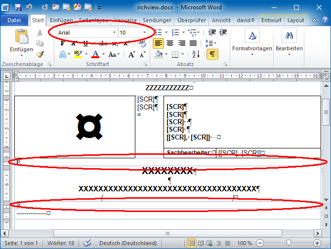

loading a docx (maybe rtf too?) with a complex table results in empty cell's assigned a default style - but in the original document these cells have a assigned style with different font and small size. The wrong font / style changes the height of the row - thats the real problem / bug.
In the load process the table cells are dynamicly splitted and merged as needed - but in case of empty cells this doesn't happen properly so that a default style stays assigned.

RichView saved DOCX opened with Word.
richview.docx
(4.75 KiB) Downloaded 4617 times
Original DOCX in Word.
original.docx
(21.62 KiB) Downloaded 4714 times
