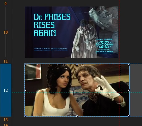

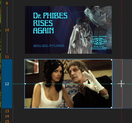

What I'm wanting to do is to match the edges of a selected image to the edge of another. A guide line would help do that. I was thinking of adding one when an image is selected and resized. I actually got that working (see below). An optional way to do it might be to add guide lines (maybe "pulled" from rulers?) but would be more complex to do. Another way would be if it was possible to select non-contiguous items (i.e. multiple images anywhere in the doc) as needed, then use a popup menu to allow matching selected image widths, heights or both to the first image selected.
Here's what I have now. The code is relatively simple and it works although it does need some additional work to check if I'm resizing horizontally or vertically and to just show the appropriate guide.
