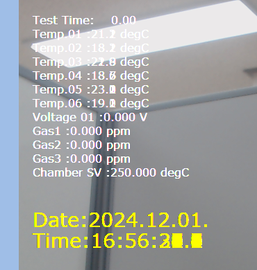

Hello
I am recording a web camera with text information using the OnGetImage event
When I used RVMediaVCLSetupVer8.exe, it was recorded well
But when I try to record using RVMediaVCLSetup_v11.exe
The web screen is overlapping with text on the screen when Camera On
What is wrong? Please advise
Thank you!

procedure TfrmMain.RVCamera1GetImage(Sender: TObject; img: TRVMBitmap);
  bmp: TBitmap;
  sDisplayStemp : Array[0..20] of String;
  iSZ: TSize;
  rDT, rTS : Real;
  iTH, iTM, iDY : Integer;
  i, iBtCnt : Integer;
  sTS : String;
  rDT := Now;
  iDY := Trunc(rDT);
  rDT := rDT - iDY;
  iTH := Trunc(rDT * 24);
  iTM := Trunc(rDT * 24 * 60) - (iTH * 60);
  rTS := (rDT * 24 * 60 * 60) - (iTH * 60 * 60) - (iTM * 60);
  if rTS > 10 then sTS := Format('%2.1f', [rTS])
    else sTS := '0' + Format('%2.1f', [rTS]);
  bmp := img.GetBitmap;
  with bmp.Canvas do
    Lock;
    try
      if CFG.bBkView then
        Brush.Style := bsSolid;
        Brush.Color := CFG.iBkCR;
        Rectangle(cfg.iSX, cfg.iSY, CFG.iEX, CFG.iEY);
      Brush.Style := bsClear;
      Font.PixelsPerInch := 96;
      iBtCnt := 0;
      IND.sVal[0] := FormatDateTime('yyyy.mm.dd.', now);
      IND.sVal[1] := Format('%2d:%.2d:', [iTH, iTM]) + sTS;
      IND.sVal[2] := Format('%8.2f', [IND.rTM]);
      for i := 0 to 20 do
        if CFG.bView[i] then
          Font.Name  := CFG.sFtNm[i];// 'Tahoma';
          Font.Color := CFG.iFtCR[i]; // clWhite;
          Font.Size  := CFG.iFtSZ[i];  // 32
          if not CFG.bStyle[i, 0] and not CFG.bStyle[i, 1] then Font.Style := [];
          if not CFG.bStyle[i, 0] and     CFG.bStyle[i, 1] then Font.Style := [fsItalic];
          if     CFG.bStyle[i, 0] and not CFG.bStyle[i, 1] then Font.Style := [fsBold];
          if     CFG.bStyle[i, 0] and     CFG.bStyle[i, 1] then Font.Style := [fsBold,fsItalic];
          sDisplayStemp[i] := CFG.sTitle[i] + IND.sVal[i] + ' ' + CFG.sUnit[i];
          TextOut(CFG.iX[i], CFG.iY[i], sDisplayStemp[i]);
    finally
      Unlock;
  img.UpdateData;

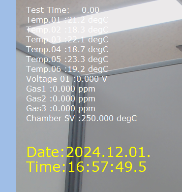

Re: Adding text to video
I confirm the problem.
Quick fix:
Open MRVWinWebCamera.pas.
Find the line:
bmp.Modified := TRUE;
Add after:
bmp.ModifiedData := TRUE;
A critical section is not needed.

Resolved
Added and confirmed no issues
