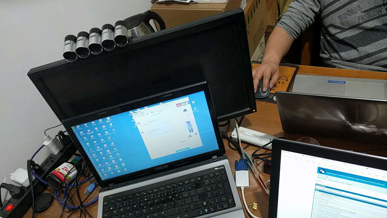

I've been trying the RVMedia for a few days, I was using 5 Microsoft USB WebCam for a 3D project.
However, RVMedia doesn't work while opening 2 or more Microsoft USB WebCams. But if you open 1 Microsoft USB WebCam and 1 laptop internal webcam, they both work well.
So, How can I handle this problem?
Thank you.

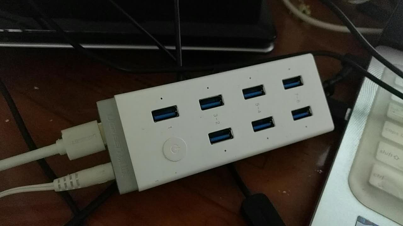

Yes I connected all cameras to a powered USB 3.0 hub as below. Maybe there is a host controller in it? and then I guess this has noting to do with the power issue.
I think your idea of the controllor make some sence, because I tried to connect 2 cameras to the laptop's internal usb ports, then 2 of the cameras worked. but the third one didn't work nevertheless.
Thanks again.

I mean it may be not a software, but a hardware problem, if all these cameras at the end are connected to a single USB port, it does not have enough bandwidth to work with them.
The developer said that you main need not a hub connected to existing USB port but a card adding new USB ports, like this one

I bought 2 of those PCI-USB cards, and 5 webcams worked well. and the single USB port for each camera still was not enough, I plug them into every port which is under a single USB controller. Actually, The CPU is another problem, now they can work well with the mode 1920*1080 16bit YUY2, and cost 55% CPU resource. IF they work with 1920*1080 24bit mpeg, then 3 of them would cost 100% CPU resource of the core i5.
