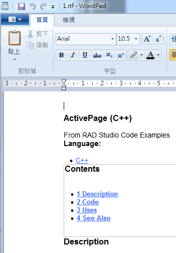

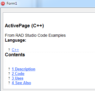

I just tried from the evaluation installation, and build a simple application (C++ Builder Berlin) to open a simple RTF file.
Then all mid dots (\'B7) become question marks (as attached 1.png).
And I used RTF Viewer, WordPad (3.png), and Winword 2016 to open the same RTF file, all the mid dots are shown properly.
Even the built-in TRichEdit control can show the mid dots properly.
I tried to change all possible RTFReadProperties.UnicodeMode values and it still has the same problem...

I cannot reproduce this problem, but I think I know the reason.
This text is in old-style RTF list marker keyword (used in Microsoft Word prior to 97 and in RichEdit). As I can see in TRichView code, text in old-style RTF list markers is always converted to Unicode using the system default charset. I guess you have some Far East charset where #$B7 is not a dot.
I'll fix this problem in the next update.

Fixed in TRichView 16.15.5
