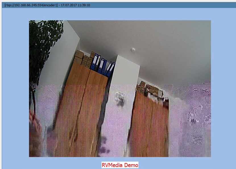

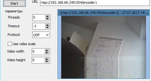

Hi!
I'm testing TRVCamera component for delphi seattle, using RVMedia 501 - unregistered version yet.
I am able to stream a live video from a camera (product of dallmeier in germany) by using rtsp protocoll. This works fine. But if I move the camera, i get blurred sections in the bottom area of my picture. The same effect occurs on displaying the video stream and doing nothing. It seems like picture "runs away". Please see the attached screenshot.
Thanks, Heike
Thanks, Heike
- kamera.jpg (114.43 KiB) Viewed 79820 times

Re: Testing RVCamera - Video blurred
As I understand, you use FFmpeg.
Please test this compiled demo:
It uses newer version of RVMedia (unreleased yet) allowing to configure FFmpeg parameters:
http://www.trichview.com/support/files/ ... ffmpeg.zip
Try changing protocol in this demo.

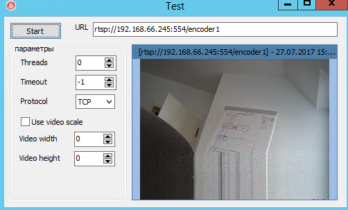

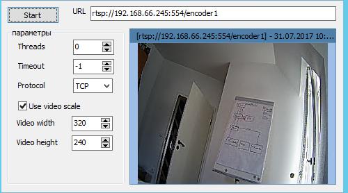

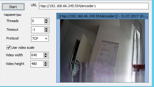

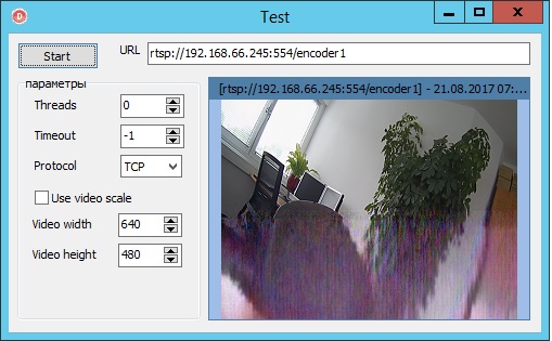

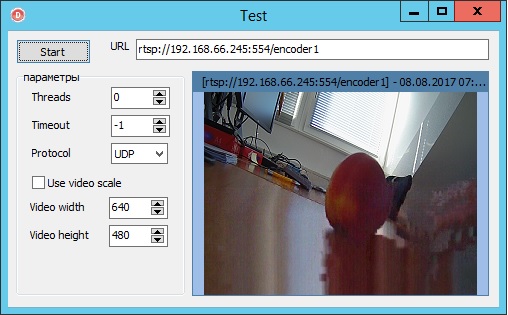

Yes, tested with your program. Unfortunately same problem with TCP. Please see enclosed screenshots.
Thanks for your help.

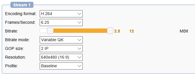

Maybe I should change some parameter in the stream configuration on the camera? Would you take a look on them and give me your opinion?

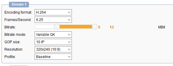

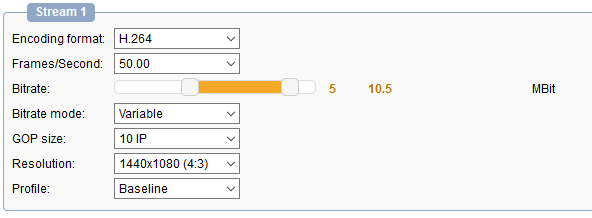

Try reducing "Frames/Second" in the camera settings. 50 fps is too much for sending via Inet, try 14
- Posts: 6
- Joined: Mon Jul 17, 2017 10:02 am
Tested with 6.25 Frames/sec and changed resolution to 320 x 240 -> works fine
changed resolution to 640 x 480 (Frames/sec still 6.25) - in camera settings and in your program -> bad Picture
Further tests with resolution and frames/sec: only resolution 320x240 works, independently from the other parameters like frames/sec, bitrate, bitrate mode (camera settings) or protocol (your program)-

Please test with higher resolution and lower bitrate and smaller GOP size.
- Posts: 6
Tested with higher Resolution and lower Bitrate and smaller GOP size => picture is worse than before

Please test the same with TCP protocol
- Posts: 6
TCP doesn't change the result.

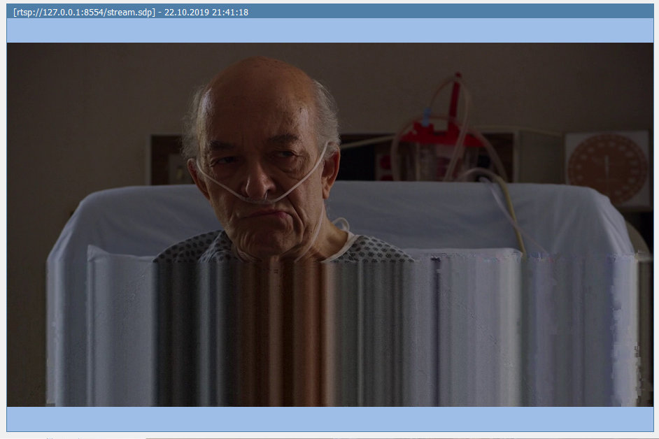

Hi!

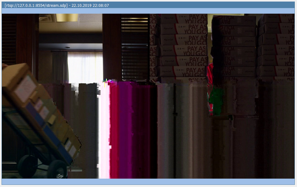

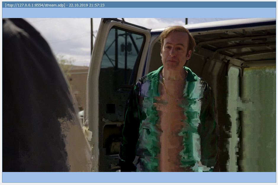

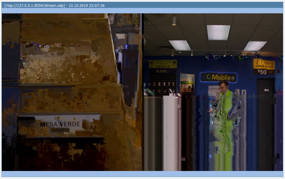

I have the same problem with rtsp and ffmpeg.
I am able to get streaming video from vlc (playing file and streaming it) by using rtsp protocoll. But if some scene changes quickly, I get blurred or corrupted sections in the bottom area of frames. ffmpeg libraries are up to date.
Video is in the following coedc: H264 - MPEG-4 AVC (part 10) (avc1)
Video resolution: 1280x720
Frame rate: 23.976023

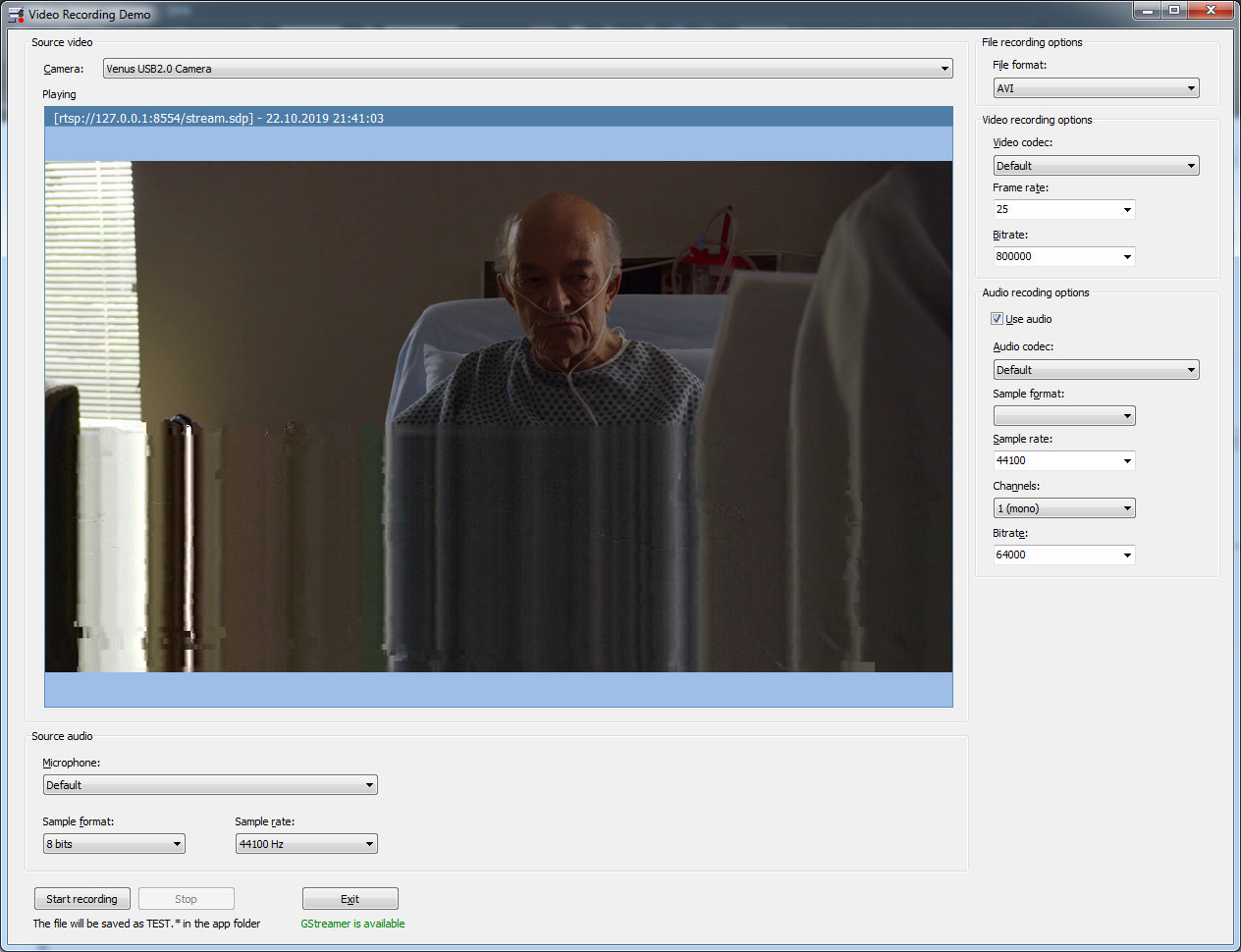

I wanted to try GStreamer, but I failed to open rtsp://:8554/stream.sdp with gstreamer (I have a full installation and it works fine without any corruption via gst-play-1.0.exe rtsp://:8554/stream.sdp). But using RVMedia I can't play video stream via gstreamer version 1.0
Can you help me get rid of this problem using ffmpeg and explain how to open it via gstreamer?

RVMedia supports GStreamer 0.1, not 1.0:
https://www.trichview.com/forums/viewto ... =17&t=9285
