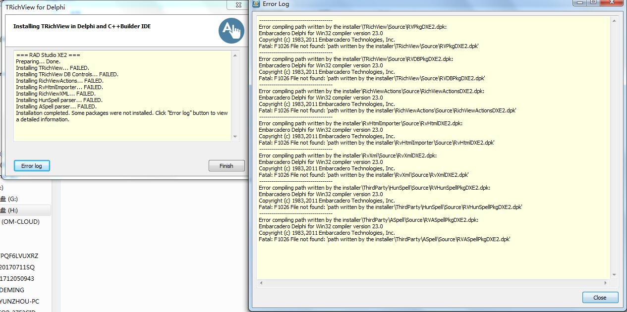

I tried to install the TRichView.v.17.03.0 on XE2.
so i use the IDEInstall.exe in the folder Setup and choose the file TRichViewFullDelphi.iide to instll it.
But it failed.
And I got a error message like this:
error mes
error mes
So what can i do next?
Posts: 17899
Re: Install issue via XE2
Very strange. "path written by the installer" is the initial value of the Files in the section [Install] in the configuration files.
But the installer must replace it with the actual value. Normally, the actual value is a corresponding environment variable.

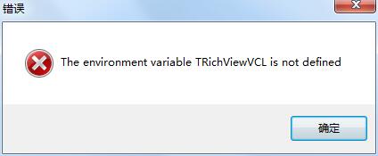

I modified the Files section to "Files=%TRichViewVCL" in the file of TRichViewFullDelphi.iide.
But when i tried to install the trichview again, i got a new wrong message:
Not Defined.jpg (8.07 KiB) Viewed 21176 times
Posts: 17899
This variable is created by the installer.
Did you run the installer (not IDEInstall, but the installer that unpacks files)?

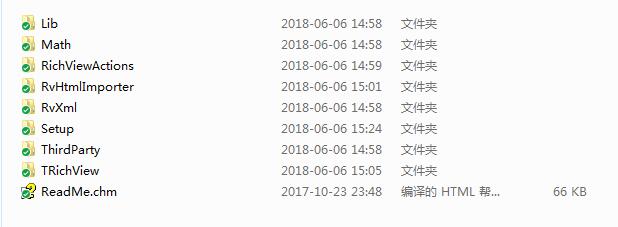

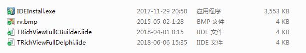

I check out my folders, but no file named installer found.
i got these files like this:
And only IDEInstall.exe in the folder Setup
Posts: 17899
Where did you get these files from? Normally, they are unpacked by the installer, named TRichViewSetup-17.exe or like this.
