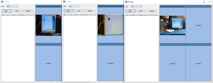

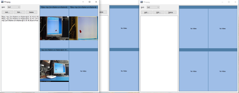

Hi all,
I'm testing the new RVMedia v7.1 ffmpeg demo project setting the "RVCamera.Latency = 0".
If I run three instances of the program connecting three differents local network cameras, they work fine, it is, the image on all the programs are more or less synchronized along the time.
But, if I setup the three cameras in one single instance of the program, the playback starts unsynchronized and finally are completely worst, slow and with a big delay between each camera.
So, summaryzing, the v7.1 is not better than v6 or v7 in RTSP multiple network camera situation.
Is there any other think I can change?
Thanks,

Re: RVMedia and RTSP - Multiple local network cameras
If you use several cameras pointing to the same dynamic image like:
a) a move,
b) road traffic,
c) never end looping image.
it is easy to see how gradually the multiview's playback of each camera slowdown until the image jumps but still far away to be synchronized.

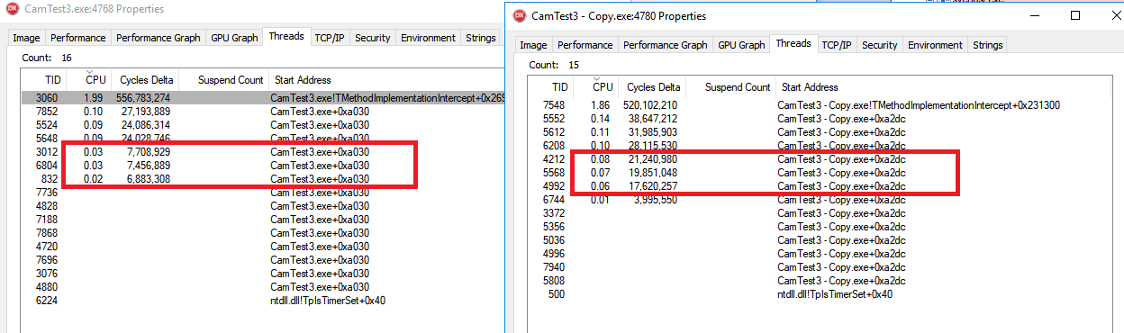

Hi Sergey and panlab_mf,
I downloaded your CamTest3 and compiled it with v6.1.1
And here is my findings:
1) Using ScaleMM and enabling optimize, the 3 cams become synchronized as shown in the attached image, while in your compiled exe there is variance.
2) Your exe always have one cam delaying the most and it is mostly cam1 (top right) as shown in the image, in fact the screenshot i took after 15 minute of running both EXE's yours and mine at the same time, and cam1 is showing images from 17 second ago
3) leaving them running around 25 minutes, now i see all 6 cams show the same images.
4) The second image is for the threads and context switching, here clearly ScaleMM helping 3 background threads become faster 3 times, while the other three threads gained less advantage.
Hope this help and save your time.
Regards
https://ibb.co/wh6ZwFy
Regards
- RVMedia_CamTest3_Threads.png (39.52 KiB) Viewed 64979 times
