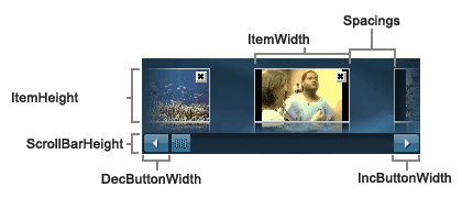

published ItemHeight
TRVPixel96Length
40
Item height

published ItemWidth
TRVPixel96Length
80

published Spacings
TRVPixel96Length
10
Spacing between items.

published DecButtonWidth
TRVPixel96Length
0
Width of up/left button in a skin mode. 0 for system default.
published IncButtonWidth
TRVPixel96Length
0
Width of down/right button in a skin mode. 0 for system default.

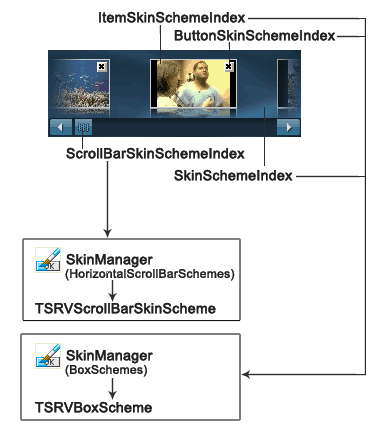

published ScrollBarSkinSchemeIndex
Integer
0
Index in SkinManager.CurrentSkin.HorizontalScrollBarSchemes (or VerticalScrollBarSchemes in a vertical mode), defines the appearance of scrollbar.
published ItemSkinSchemeIndex
Integer
0
Index in SkinManager.CurrentSkin.BoxSchemes, defines the appearance of each item.
published ButtonSkinSchemeIndex
Integer
0
Index in SkinManager.CurrentSkin.BoxSchemes, defines the appearance of closing buttons.

If SkinManager is assigned, the control is drawn using SkinManager.CurrentSkin.BoxSchemes[SkinSchemeIndex], the scroll bar is drawn using SkinManager.CurrentSkin.HorizontalScrollBarSchemes[ScrollBarSkinSchemeIndex] (or VerticalScrollBarSchemes, if a scroll bar is vertical).
Example:
SRVImagesScroll Scheme
