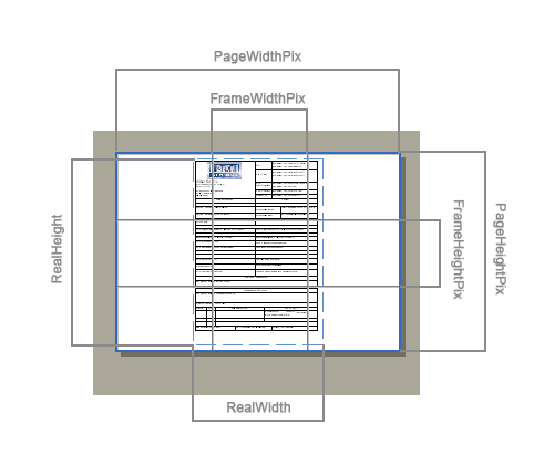

Posters
Sizes
A document is prepared in TSRichViewEdit component . Its size is defined in TSRichViewEdit's page properties.
Each page of this document is scaled to RealWidth x RealHeight (see below how they are calculated).
Each page of this document is printed as a poster. The poster consists of frames. Frame is one paper sheet, it has size of the printer's paper (FrameWidthPix x FrameHeightPix, orientation Orientation).
The poster consists of Ceil(FrameCountX) x Ceil(FrameCountY) frames (so, each page of the original document will be printed on Ceil(FrameCountX)*Ceil(
FrameCountY) printer pages).
The poster size in pixels is PageWidthPix x PageHeightPix (i.e. Ceil(FrameCountX)*FrameWidthPix x Ceil(FrameCountY)*FrameHeightPix).
FrameCountX  and FrameCountY can be fractional values (if IntegerCount  = False), it affects calculation of RealWidth and RealHeight  (see below).
Sizes in posters
Sizes in posters
How the document page is scaled
As it was said above, each page of the original document is scaled to RealWidth x RealHeight.
If ScaleImage = True, pages are scaled to the full poster size (RealWidth = PageWidthPix , RealHeight = PageHeightPix), without keeping the original proportions.
If ScaleImage = False, pages are scaled proportionally to the maximal size that fits in TotalFrameWPix x TotalFrameHPix (so RealWidth<=TotalFrameWPix, RealHeight<=TotalFrameHPix).
TotalFrameWPix  and TotalFrameHPix are similar to PageWidthPix and PageHeightPix, but calculated without rounding, i.e. they are equal to FrameCountX*FrameWidthPix x FrameCountY*FrameHeightPix.
If ScaleImage = False, the document page can be printed in the top left corner or in the center of the poster, depending on the Center property.
See also: UsePhysicalOffsets.
